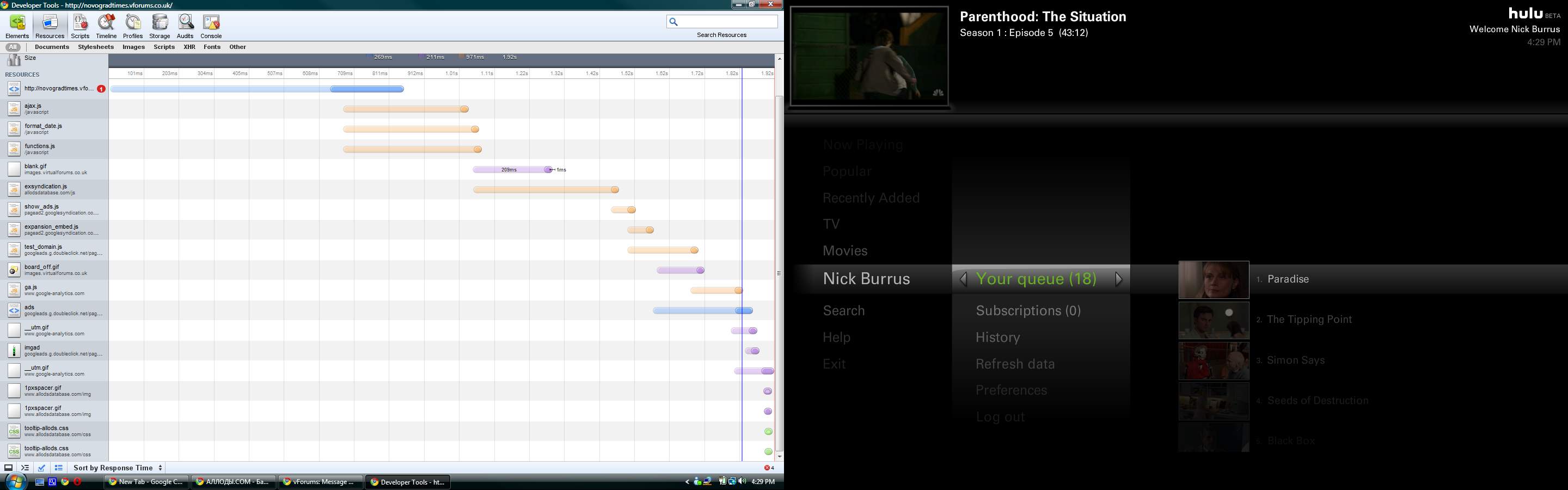

Chrome resources: http://uploads.virtualforums.co.uk/forums/support/resources-v0k.jpeg
It's only the forums that take a while to access. Everything else is perfectly fine including the support forums. It's just when trying to access my forum.

Seems like quite a lot of slow hops to get to the server.
